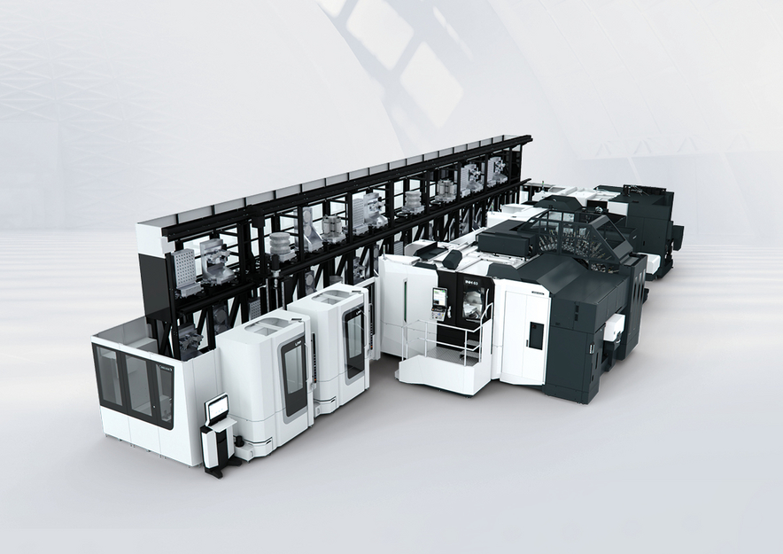

The INH 63 and INH 80 are good examples of the strong focus that DMG MORI places on sustainable progress in the form of Machining Transformation (MX). Process integration, automation, Digital Transformation (DX) and Green Transformation (GX) are the main pillars here. Their increasing interaction clearly shows that sustainability and operational excellence are by no means contradictory goals but can successfully go hand in hand. The integration of different manufacturing processes in one machine – turning, milling and other processes such as measuring or gear cutting – shortens the process chain. Set-up times are reduced, while quality increases. Overall, resource efficiency increases, which contributes to sustainability. Integrated into flexible production cells and systems, the INH 63 and INH 80 can also work unattended for up to three shifts. Automated tool and pallet handling and the intelligent CELL CONTROLER LPS 4 master computer increase the productive spindle hours from 2,000 to over 6,000 per year compared to the stand-alone installation. The equipment with digital technologies also allows integration into holistic production systems. The GREENMODE also has a direct impact on the Green Transformation (GX). It reduces the energy consumption of the machines by over 30 percent and optimizes the use of resources at the same time.

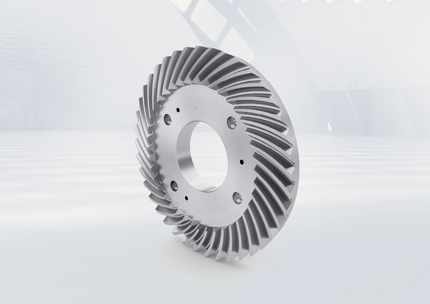

Using the example of a high-precision spiral bevel gear for industrial wind turbines, the INH series demonstrates its capabilities in terms of efficiency and sustainability. The gear element is made of robust steel and measures ø 482 x 66 mm. By integrating manufacturing processes such as 5-axis milling, gear cutting and in-process measuring in one work area, both horizontal machining centers are able to completely manufacture the bevel gearbox in a single clamping operation. Transport between the previously separate machining stations is no longer necessary. This saves idle times and increases precision at the same time. This is because each repositioning creates space for potential errors. Gear cutting with standard tools plays a major role in complete machining. The 5-axis performance combined with the respective DMG MORI technology cycles enable gear cutting processes such as roughing and finishing on standard machines. Specialized and therefore expensive single-purpose gear cutting systems are not required. With regard to digital transformation (DX), 1:1 simulation and the accompanying analysis of process data ensure optimum machine utilization. This reduces the risk of machine downtime and ensures greater energy efficiency. Up to 80 percent of power consumption can be saved per component. All in all, this use case shows that the INH series combines all elements of Machining Transformation and can be used to optimize machine utilization. All in all, this application shows that the INH series combines all elements of the Machining Transformation and applies them to future markets such as wind power. The INH 63 and INH 80 combine economic efficiency with ecological foresight, creating a role model for the machine tool construction of the future.
