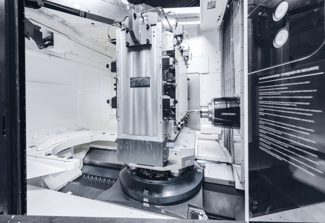

Each NHX 8000 has a pallet changer with one fixture per pallet, each of which is equipped with a panel at both sides. Two floor panels are manufactured in a single machining process.

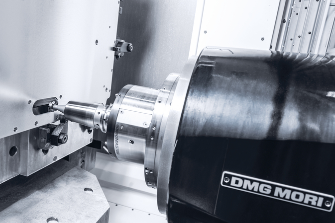

The NHX 8000 machines at PWS are equipped with #40 speedMASTER spindles as a special option.

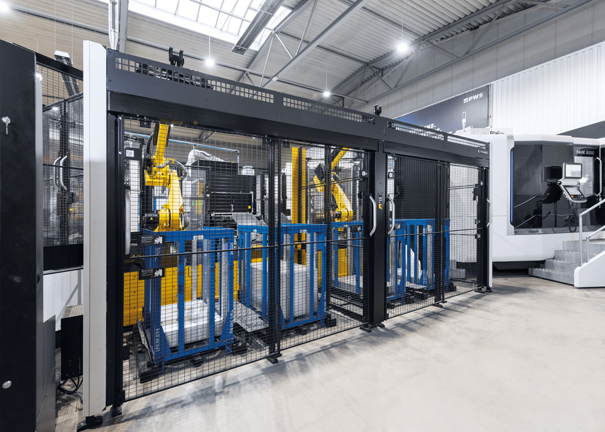

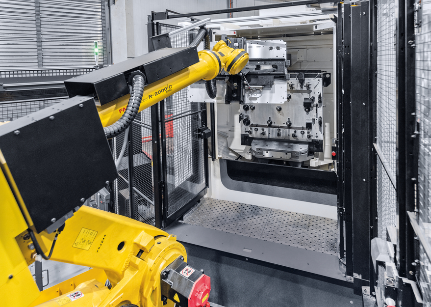

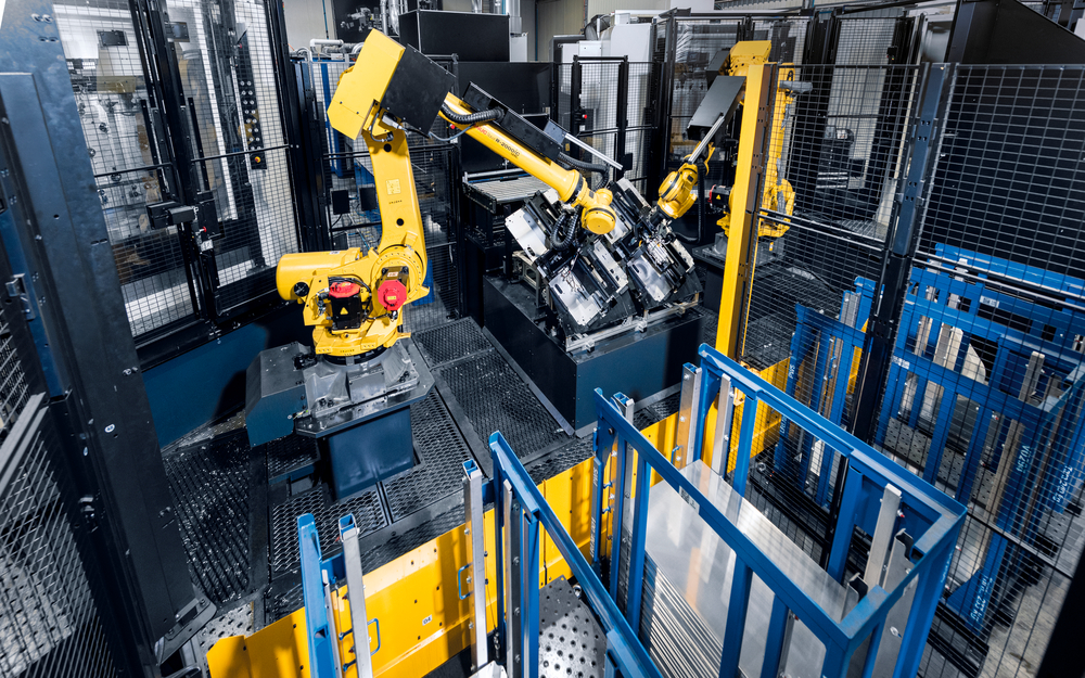

PWS transfers the unmachined parts into the system using a special load carrier developed in-house with room for more than 100 panels. Two robots handle the workpieces at the center of the MATRIS system. The components are aligned and automatically clamped in the fixture at both sides. The two components that have already been machined are removed and transferred to the other stations. “The finished parts are cleaned using a blow-off device, a camera inspection system checks the holes and the parts are processed in a deburring machine. Each panel is then laser-marked with a QR code and scanned. “We use this to record all production data digitally in order to guarantee complete traceability,” says Steffen Metz. “The smooth process provides floor panels that are ready to install.” For further quality assurance, the MATRIS system was subsequently supplemented with a washing system and a flatness checker.
