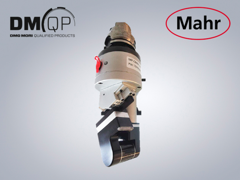

The Mahr Group from Göttingen has joined DMG MORI's DMQP program with its new contact free measurement system, MarSurf MC 510. DMG MORI Qualified Products (DMQP) are characterized by the perfect synergy of DMG MORI machines, peripherals, and accessories. The MarSurf MC 510 is a vibration-resistant, tactile free touch measurement system for measuring the surface roughness of workpieces with an accuracy of up to Rz 1.

MarSurf MC 510 surface measuring system from Mahr: The MarSurf MC 510 system will be the latest addition to the global DMQP portfolio from September. Dr.-Ing. Masahiko Mori, President and CEO of DMG MORI Co. Ltd., and Manuel Hüsken, CEO-Chairman of the Board, Carl Mahr Group, formalized the cooperation between their companies for the DMQP distribution of the MarSurf MC 510 contact-free measurement system in mid-September.

MarSurf MC 510: The MarSurf MC 510 enables, for the first time, standard-compliant in-situ measurements with an accuracy of up to Rz 1 directly in the workspace.
