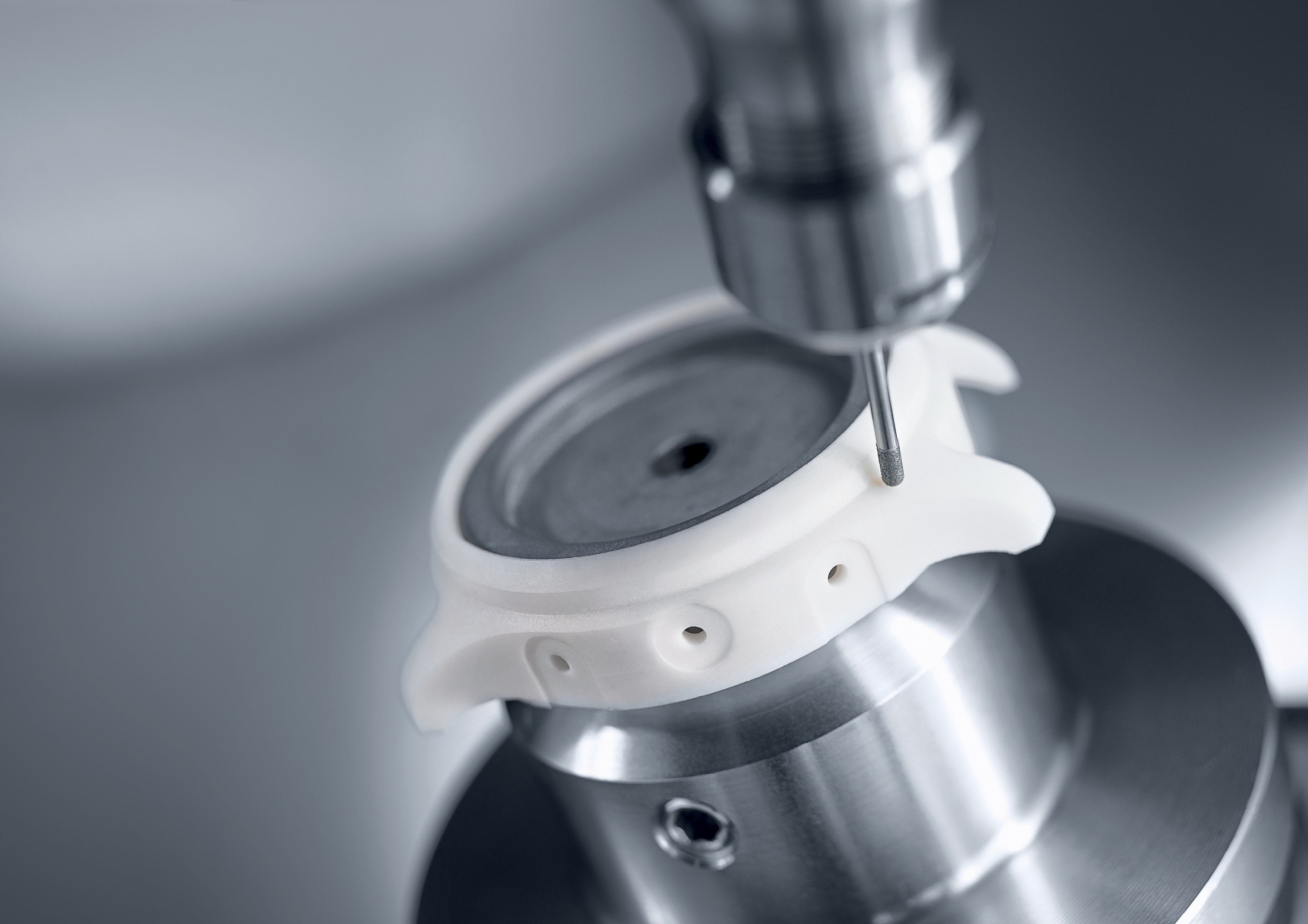

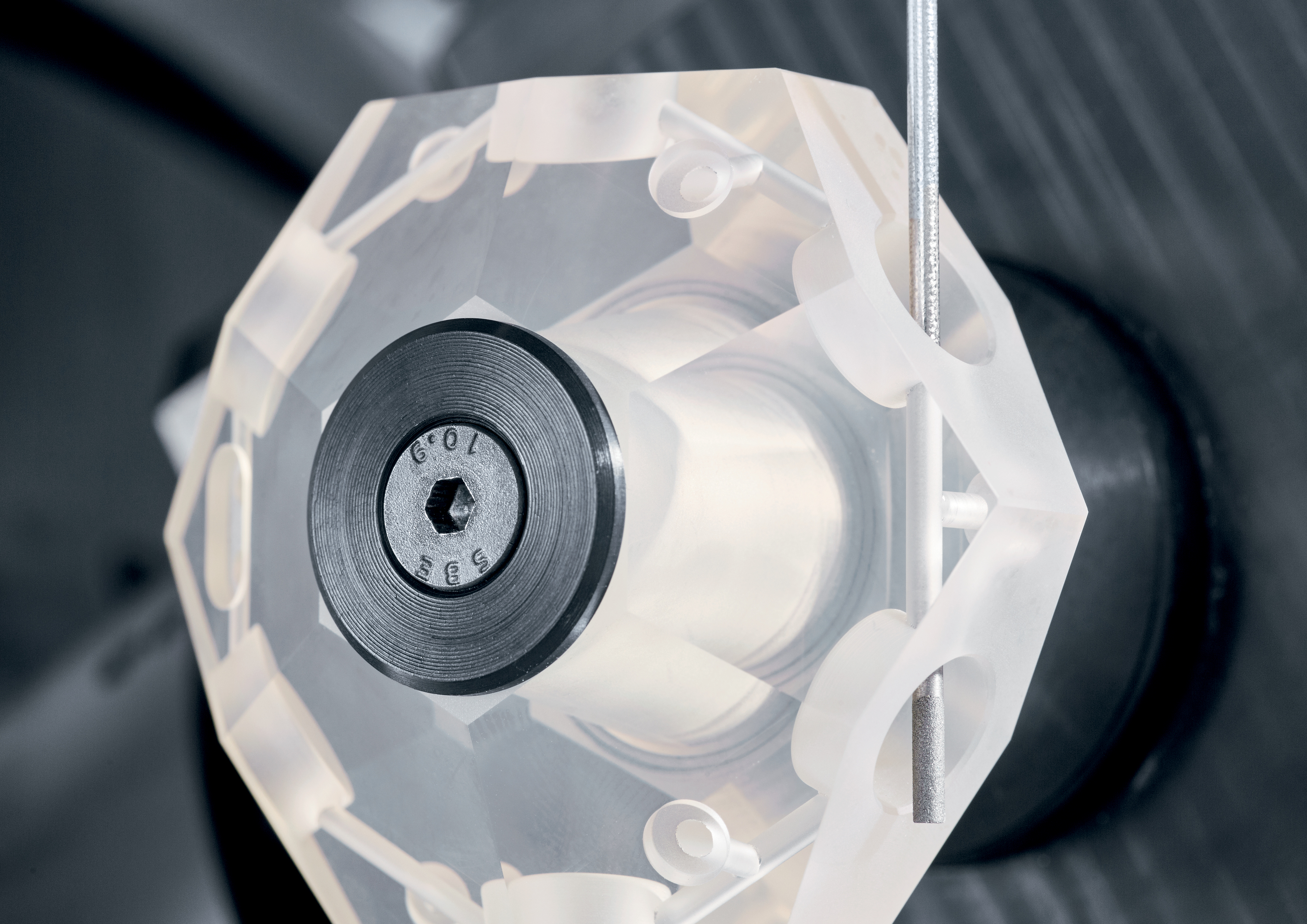

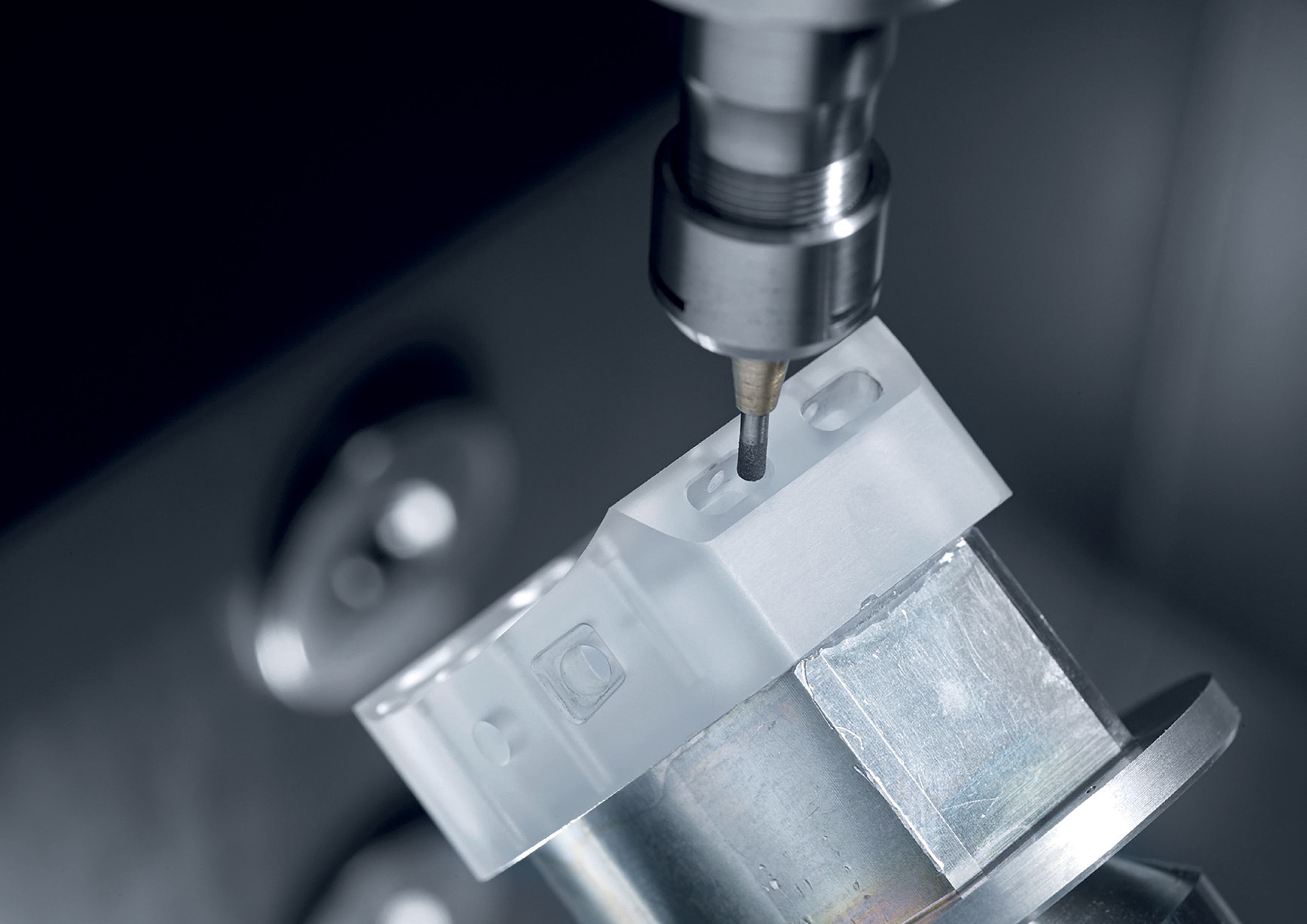

The new DMU 20 linear and the ULTRASONIC 20 linear 3. Generation as a variant for ultrasonic-supported grinding prove once again that DMG MORI also continues to develop proven technologies with a high degree of innovative strength. The machine tool manufacturer has completely revised the world premiere with the experience gained from 600 installed predecessor models and entered a new sphere of positioning accuracy. 3 µm in the linear axes and 3" in the rotary swivel axis surpass even µPrecision technology. Equipped with ULTRASONIC technology, the most precise 5-axis simultaneous machining center from DMG MORI revolutionizes ultrasonic-supported milling and (optional) grinding of advanced materials such as glass, ceramics and demanding composite materials, for example in the semiconductor industry. The ultrasonic superimposition of the tool rotation with amplitudes of up to 15 µm reduces process forces by 50 percent and enables higher feed rates, improved surface finishes and longer tool life as required.

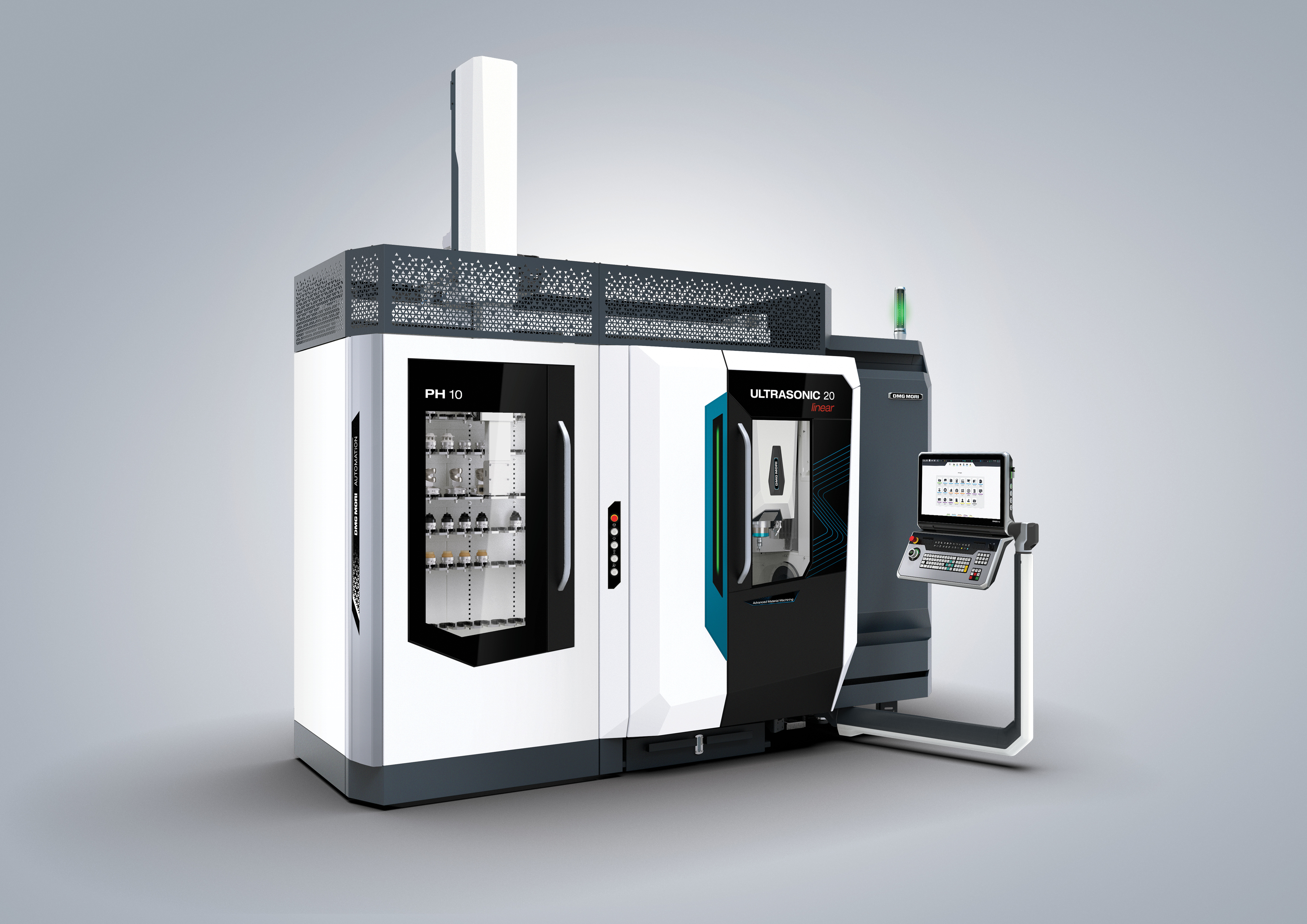

The increased travel of the compact DMU 20 linear - it only requires a footprint of 3.8 m² - is 220 x 370 x 290 mm, which means that the Y-axis has increased by 80 percent compared to the previous model. This is mainly due to the larger swivel range of +130° to -93°. The axis can be swiveled in the direction of the operator, which offers a better view of the table and more flexibility. Components with a diameter of ø 220 mm and a height of 283 mm (with Erowa ITS clamping system) can be machined.
Ultrasonic-assisted machining with process integration and automation solutions
Process integration and automated production are key pillars of the Machining Transformation (MX) practiced by DMG MORI. The machine tool manufacturer has also taken this into account in the case of the ULTRASONIC 20 linear 3rd generation - with ULTRASONIC grinding. The C-axis is optionally available with 1,500 rpm, so that the machine can also perform cylindrical grinding operations. The Schunk NSA 120 clamping system is offered exclusively with this option, as it fulfills maximum safety guidelines. With the ULTRASONIC AxialGrinding technology cycle, any 3D geometries based on rotationally symmetrical blanks can be conveniently programmed. The process integration is supplemented by in-process measurement and laser tool measurement. Automation solutions such as the PH 10 and PH 50 pallet handling systems or robot-assisted systems such as the MATRIS light ensure additional productivity even in unmanned shifts.
