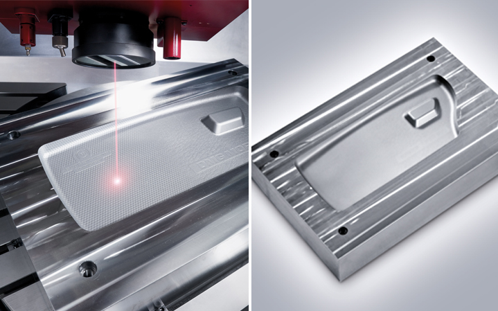

With the innovative LASERTEC Shape technology, DMG MORI has set new standards in the mould making sector – representation of a glove compartment cover with combined honeycomb/leather structure
