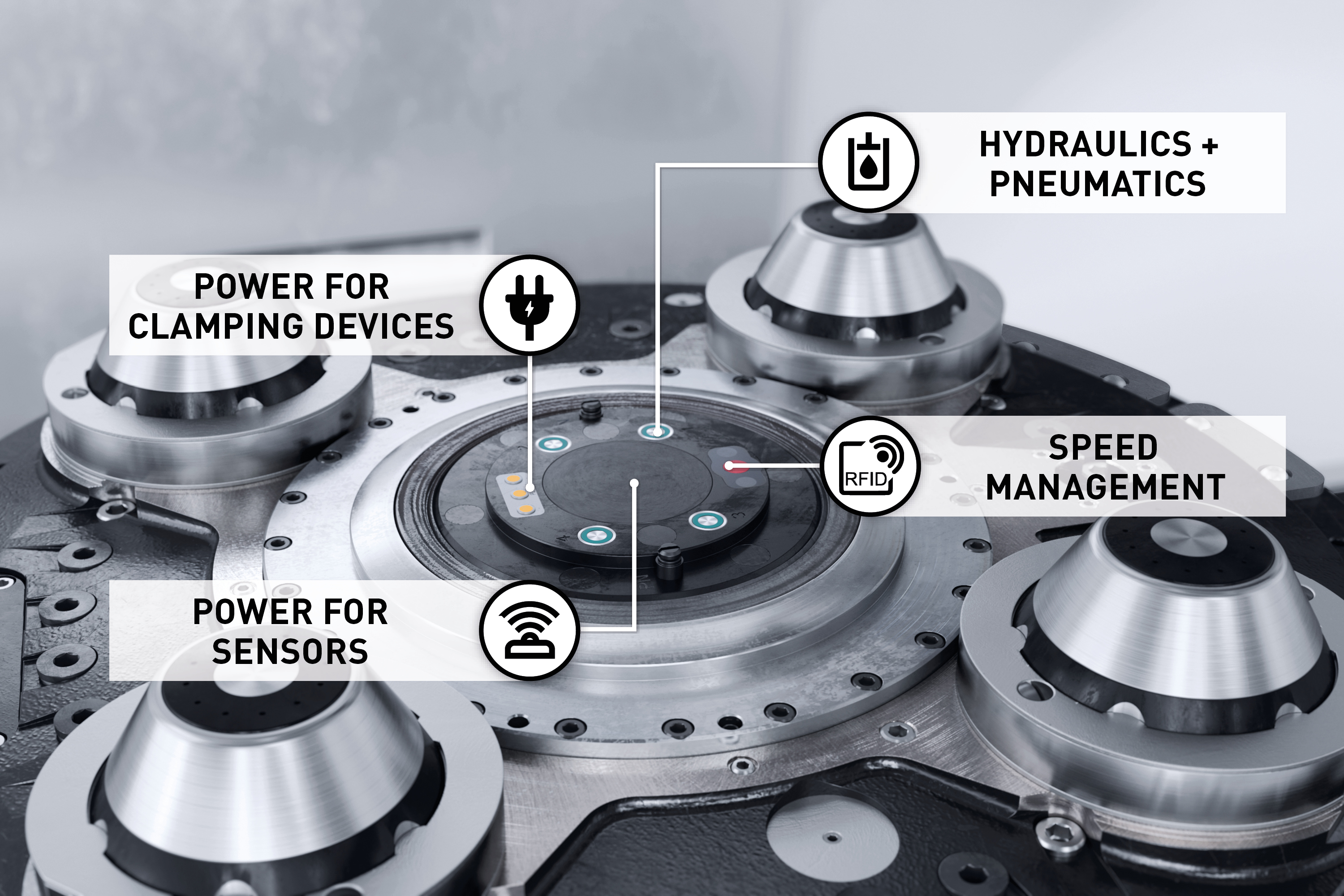

The E-Pallet has a smart interface for controlling electrical and hydraulic devices.
Hydraulic workpiece clamping offers numerous advantages, high clamping forces with simultaneous automation of clamping processes. In addition to these advantages, however, there are also challenges: higher energy costs, additional floor space of aggregates and a high variance of rotary unions. Their number of channels is limited, which limits the possibilities for process monitoring. DMG MORI has found a suitable answer with the E-Pallet, a smart interface for controlling electrical and hydraulic devices.
The E-Pallet interface can provide power for all-electric clamping devices with 48 V and 50 A via docking. It provides current for sensor technology (24 V / 4 A), which is transmitted inductively. This allows permanent interrogation of sensors.
In addition to power, the new interface can transfer up to four channels with hydraulics or pneumatics as usual. By using electrical directional control valves on the clamping device, these channels can be intelligently expanded, which removes the channel limitation. Another innovation at E- Pallet is safe speed management using RFID technology. This enables individual speed limitations of pallets and thus mixed operation of milling and turning applications on the same machine.
